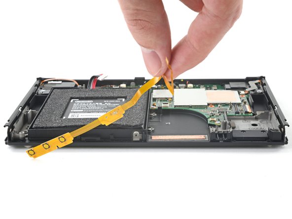

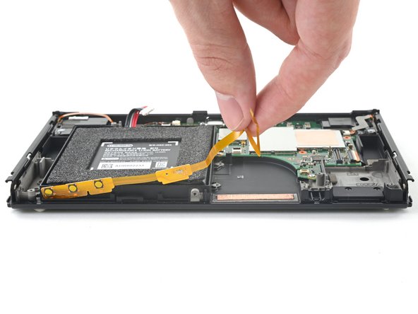

  37. Nintendo Switch OLED Model Power Button Board Replacement, Separate the power board button's adhesive: paso 37, imagen 1 de 3 Nintendo Switch OLED Model Power Button Board Replacement, Separate the power board button's adhesive: paso 37, imagen 2 de 3 Nintendo Switch OLED Model Power Button Board Replacement, Separate the power board button's adhesive: paso 37, imagen 3 de 3
    • Use your fingers to gently peel back the power board button's cable from the frame.

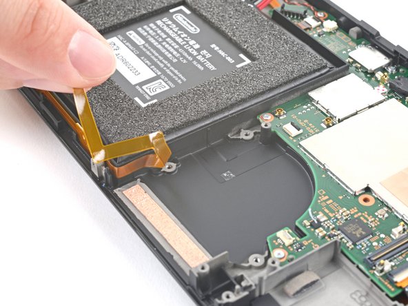

  38. Nintendo Switch OLED Model Power Button Board Replacement, Remove the power button board: paso 38, imagen 1 de 3 Nintendo Switch OLED Model Power Button Board Replacement, Remove the power button board: paso 38, imagen 2 de 3 Nintendo Switch OLED Model Power Button Board Replacement, Remove the power button board: paso 38, imagen 3 de 3
    • Use your fingers to pull the power button board out from its plastic slots in the frame.
    • Remove the power button board.
