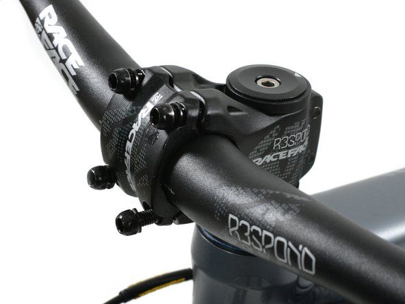

    • Loosen the bolts of the stem with the torque wrench and remove its faceplate completely.
    • Take a bit of the assembly paste and apply a thin layer of it on the inner side of the faceplate as well as in the clamping area of the stem body.
    Pregunta a FixBot
    Agregar Comentario
  3. How to set up your Strive AL 6.0 Race: paso 3, imagen 1 de 3 How to set up your Strive AL 6.0 Race: paso 3, imagen 2 de 3 How to set up your Strive AL 6.0 Race: paso 3, imagen 3 de 3
    • Position the handlebar centered in the stem clamp and put the faceplate back on.
    • Retighten the bolts of the faceplate while the bar is in a adequate position with slightly pointing down brake levers, until they hold the bar.
    • Now tighten the bolts in a cross pattern, starting with upper left going to lower right, then upper right going to lower left. The torque wrench value for this should be around 8 Nm.
    • Make sure the upper and lower gaps between faceplate and stem body are parallel and with an identical width.

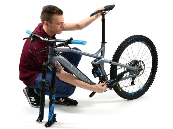

    • Attaching the saddle to the frame is a piece of cake. Take the saddle and apply assembly paste to the bottom part of the seat post, around the clamping area of it and inside the seat tube.
    • Slide the saddle into the seat tube while pulling out the cable at the lower end of the tube.
    • Note the minimum and maximum height markings on the seat post.
    • Tighten the bolt of the clamp with the torque wrench.
