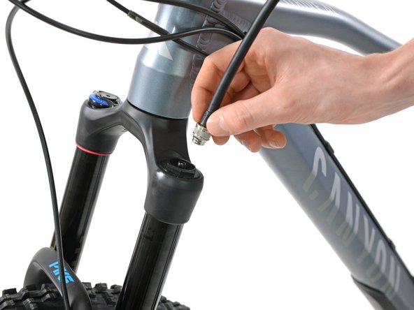

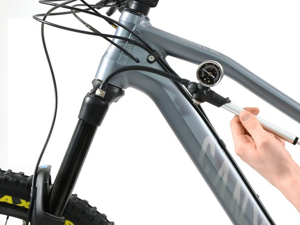

  6. How to fine adjust your Strive AL 6.0 Race, Suspension fork air pressure: paso 6, imagen 1 de 3 How to fine adjust your Strive AL 6.0 Race, Suspension fork air pressure: paso 6, imagen 2 de 3 How to fine adjust your Strive AL 6.0 Race, Suspension fork air pressure: paso 6, imagen 3 de 3
    • Remove the cap on the left side of the suspension fork.
    • Screw your suspension pump into the designated thread.
    • Go on and give your suspension fork some pressure! Consider the weight table printed on to your fork.
