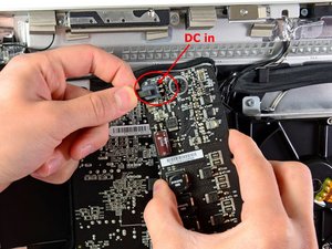

La pantalla de mi mac no enciende backlight
Hola, desmonté un iMac para cambiar el disco duro y reprogramar el firmware de la bios y a la hora de volver a montarlo, la pantalla no enciende el backlight
  • La pantalla del MAC muestra imagen, si apuntas con una linterna se ve imagen
  • Si conectas una pantalla externa se ve imagen y todo bien
  • Los leds de la pantalla funcionan correctamente, aún así probé con 2 pantallas
  • Cambié la placa del inverter
  • Se iluminan toda la secuencia de leds incluido el Led4
Alguna pista?
Muchas gracias!

@miguelange57370 how/why did you update the firmware? Did the backlight work before? Do both screens have known working backlights for sure?
Your logic board should be a 820-3126-A. Try this:
inspect and reseat the following cable connections:
  • Output cable between lower end of LED backlight board and lower end of LCD panel.
  • Vertical sync cable between upper end of LED backlight board and LCD panel.
  • DC power cable between upper right of LED backlight board and power supply.
  • Replace any damaged cable.
  • Reinstall LCD panel
Inspect and reseat DisplayPort cable between LCD panel and logic board.
Check the power to your inverter (4 pin or 6 pin connector?) to make sure that your inverter gets power. The left and right outside connectors are the power connectors.
There is a possibility that your back;light enable circuitry may have issues. Here is the schematic for that. See if all of those parts are functioning. Check for the 3.3V on your inverter as well. It is one of the inner contacts on the inverter connector

@miguelange57370 Here is the connector for your inverter.
Let us know what voltages you get. those are DC voltages. If you do not get the BLO Backlight on Voltage, your inverter does not get the signal to turn the backlights on. In that case you would need to check the circuitry on the logicboard.

@miguelange57370 LED driver board DC power connector

Hello again @oldturkey03, I have tried what you told me, the panel is installed correctly, the cables seem to be fine at first glance, I have also tried others and nothing. I need to see the diagram because I don't really know what it refers to, the back of the motherboard? To test the 3.3V of the inverter where you would have to perform the test. Thank you a million, I'm at that point where one is blocked. The power cable that goes from the bottom left to the inverter board is 6 pin. And yes, my board is 820-3126-A
