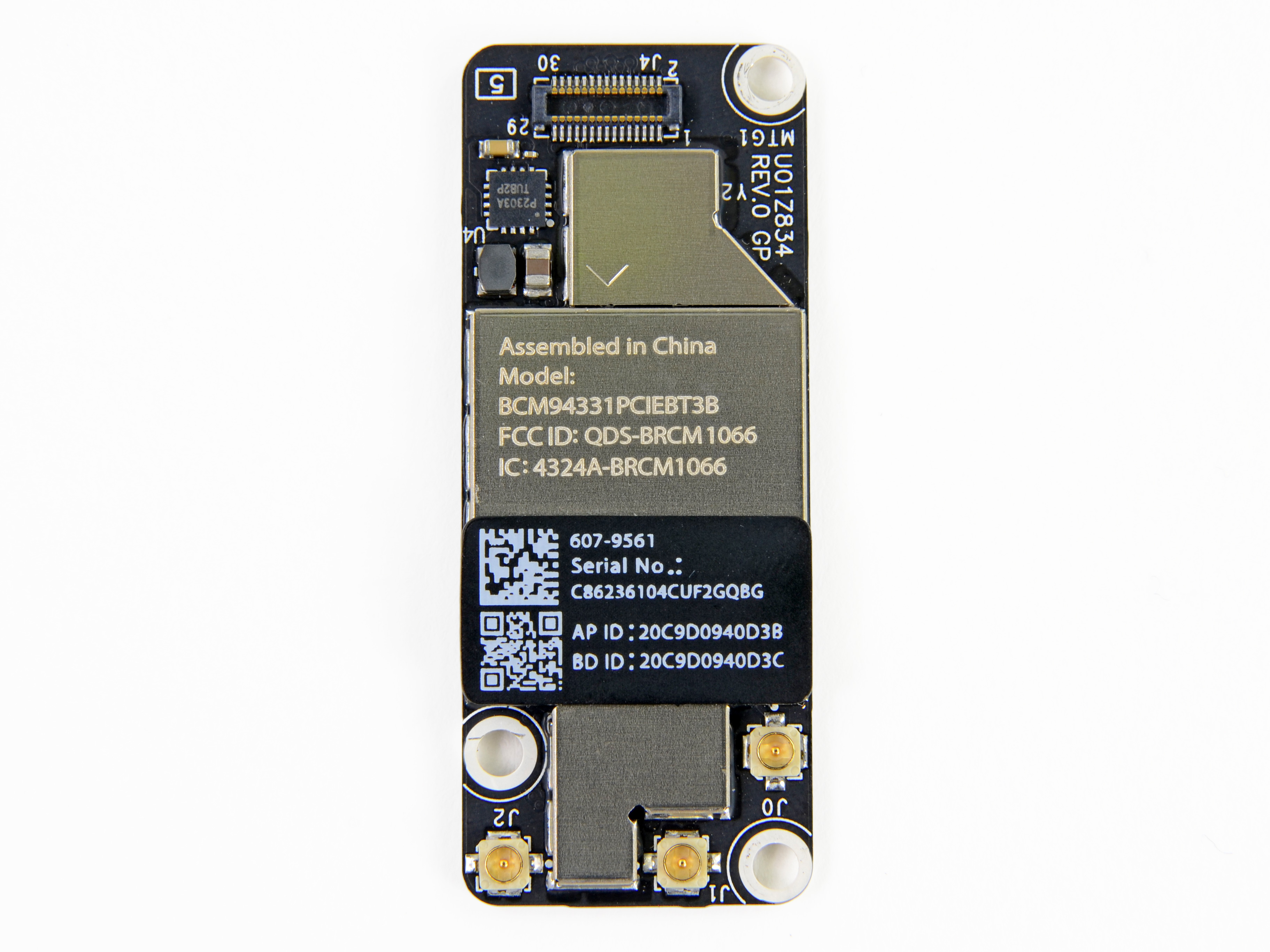

Is it possible, with the existing antenna setup in a late 2012 MacMini to replace the wifi card with a current 802.11ac card?

Not really - as with a laptop there's more to it than just a card. You'd need an 802.11ac router, and, a very fast internet connection to the router. Additionally the problem is that the new board is lots shorter than the old board so the antennas don't connect.

Upgrading the card is not really feasible here since the newer Minis have different mainboards and a different configuration for the WiFi card. The 2012 card connects with a little ribbon cable, the 2014 is a slot (mini PCIE or something of that nature). You'll be way ahead to use an external USB dongle WiFi if you want/need the ac speed.

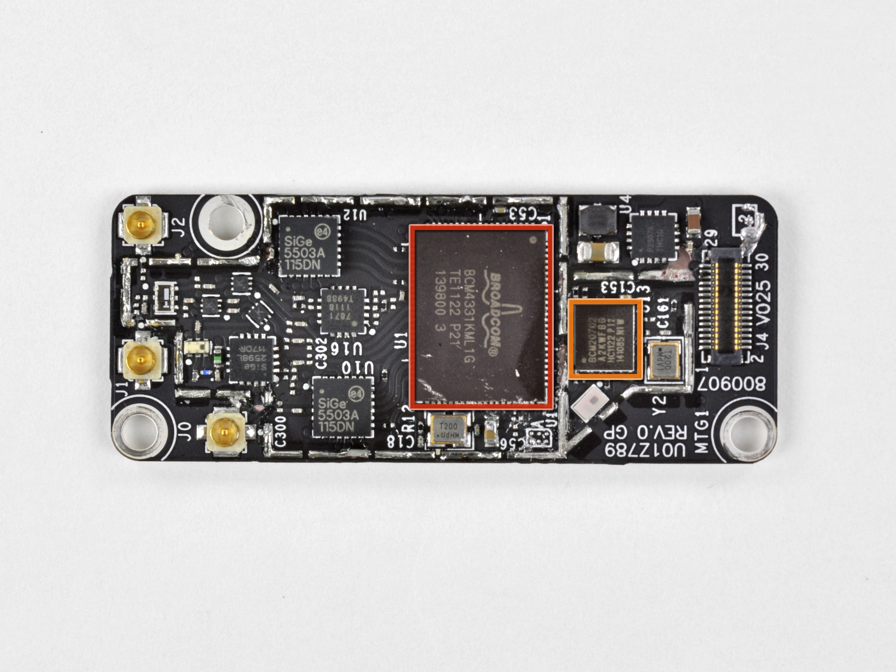

As for the lack of a Unibody AirPort card upgrade: Broadcom the supplier kept a few people waiting for the production run of the newer board. Quickertek got ahold of engineering samples which they sold for a short time then they kept taking orders expecting the part to be released. Sadly, Broadcom pulled it. All of the last Unibody systems (13" &15") use a surface mount connection as seen here: MacBook Pro Unibody (Early 2011 through Mid 2012) AirPort/Bluetooth Board unlike the newer retina series which uses an edge connection. So unless you were lucky on getting one of the engineering samples your SOL!
As for the Mac mini 2011 & 2012 it is still a different board (narrower and also has the surface mount connection) and there was no upgrade offered (802.11a/b/g/n only). The newer Late 2014 uses the edge type of board.
