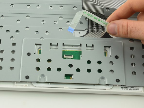

  8. One Education Infinity:One Keyboard Replacement, Keyboard Frame Prerequisite: paso 8, imagen 1 de 2 One Education Infinity:One Keyboard Replacement, Keyboard Frame Prerequisite: paso 8, imagen 2 de 2
    • Use a spudger to lift up the black retaining flap on the touchpad's ZIF connector.
    • Pull the ribbon cable straight back to remove.
