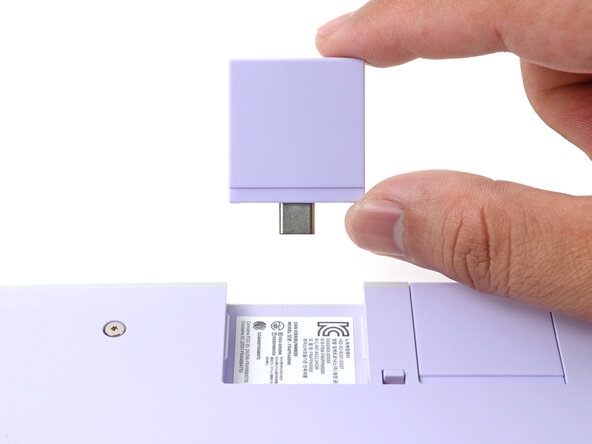

  2. How to Install and Remove Expansion Cards, Install an Expansion Card: paso 2, imagen 1 de 3 How to Install and Remove Expansion Cards, Install an Expansion Card: paso 2, imagen 2 de 3 How to Install and Remove Expansion Cards, Install an Expansion Card: paso 2, imagen 3 de 3
    • The next two steps show how to install an Expansion Card.
    • Slide an Expansion Card into an Expansion Card slot.
    • You don't need to unlock the latches to install the Expansion Cards—only when you want to remove them.
    • The Expansion Cards should click into place, and the front edge should be flush with the laptop.

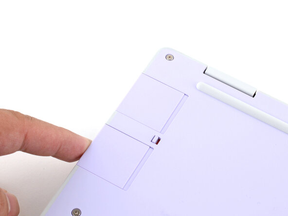

  3. How to Install and Remove Expansion Cards: paso 3, imagen 1 de 2 How to Install and Remove Expansion Cards: paso 3, imagen 2 de 2
    • If there's a red bar showing under the Expansion Card latch, use your finger to flip the latch and lock the Expansion Card into its slot.
    • Locking the Expansion Card slots helps keep the cards in place when you unplug cables from them.

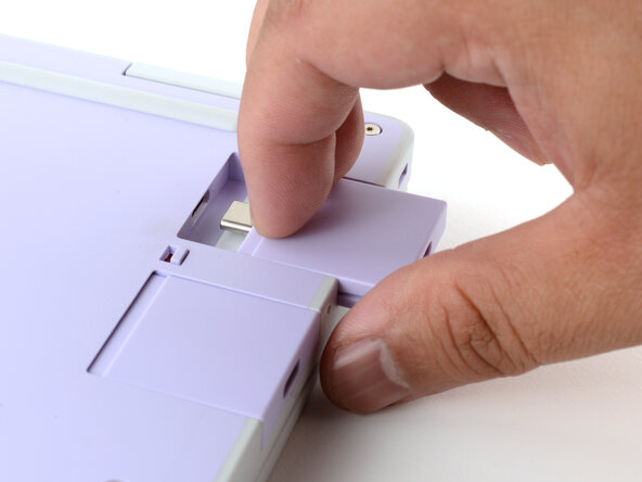

  5. How to Install and Remove Expansion Cards: paso 5, imagen 1 de 3 How to Install and Remove Expansion Cards: paso 5, imagen 2 de 3 How to Install and Remove Expansion Cards: paso 5, imagen 3 de 3
    • Grip the lip of the Expansion Card with your fingers.
    • Pull the Expansion Card out of its slot and remove it.
    • If you have trouble pulling the Expansion Card out, you can also use the flat end of your Framework Screwdriver to push against the lip.
