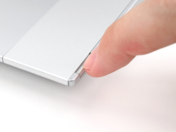

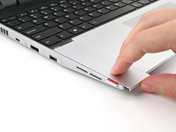

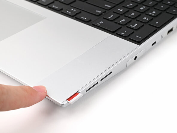

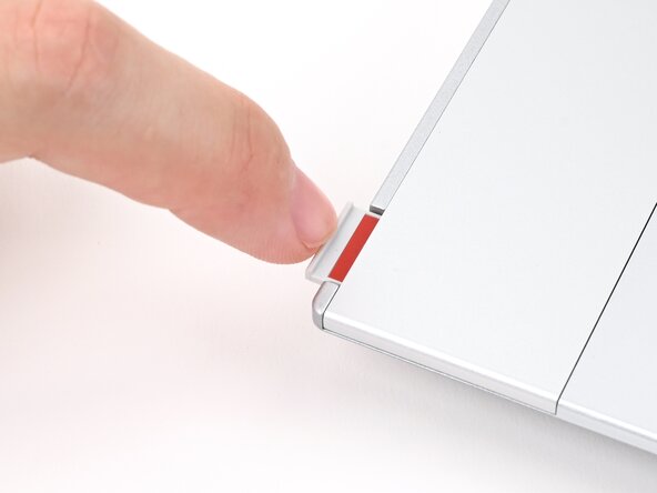

  2. Framework Laptop 16 Graphics Module Fan Replacement, Unlock the Input Modules: paso 2, imagen 1 de 3 Framework Laptop 16 Graphics Module Fan Replacement, Unlock the Input Modules: paso 2, imagen 2 de 3 Framework Laptop 16 Graphics Module Fan Replacement, Unlock the Input Modules: paso 2, imagen 3 de 3
    • Use your fingernail to pull out the two Input Module latches and unlock them.
    • The latch will show red if it's unlocked.

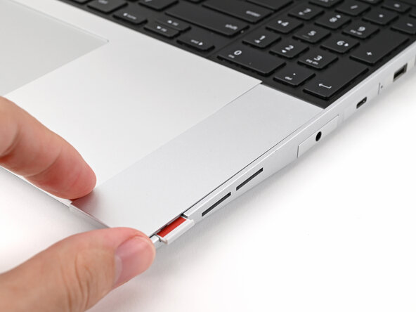

  3. Framework Laptop 16 Graphics Module Fan Replacement, Remove the Touchpad Spacers: paso 3, imagen 1 de 3 Framework Laptop 16 Graphics Module Fan Replacement, Remove the Touchpad Spacers: paso 3, imagen 2 de 3 Framework Laptop 16 Graphics Module Fan Replacement, Remove the Touchpad Spacers: paso 3, imagen 3 de 3
    • Use your fingers to slide the Touchpad Spacer toward the bottom edge of the laptop and unclip it.
    • If you're having trouble, check if the corresponding Input Module latch is properly unlocked.
    • Lift the Touchpad Spacer off the laptop and remove it.
  4. Framework Laptop 16 Graphics Module Fan Replacement: paso 4, imagen 1 de 3 Framework Laptop 16 Graphics Module Fan Replacement: paso 4, imagen 2 de 3 Framework Laptop 16 Graphics Module Fan Replacement: paso 4, imagen 3 de 3
    • Repeat the same procedure for the other touchpad spacer.

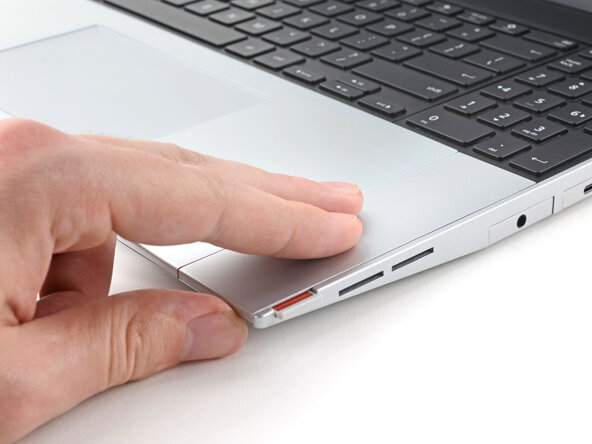

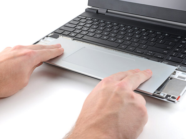

  5. Framework Laptop 16 Graphics Module Fan Replacement, Remove the Touchpad Module: paso 5, imagen 1 de 3 Framework Laptop 16 Graphics Module Fan Replacement, Remove the Touchpad Module: paso 5, imagen 2 de 3 Framework Laptop 16 Graphics Module Fan Replacement, Remove the Touchpad Module: paso 5, imagen 3 de 3
    • Use your fingers to slide the Touchpad Module toward the bottom edge of the laptop and disconnect it.
    • If you're having trouble, check if the Input Module latches are properly unlocked.
    • Lift the Touchpad Module and remove it.

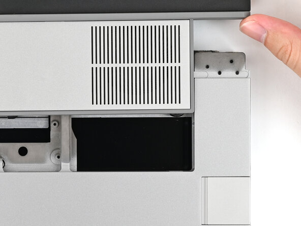

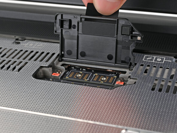

  8. Framework Laptop 16 Graphics Module Fan Replacement, Lift the interposer door: paso 8, imagen 1 de 2 Framework Laptop 16 Graphics Module Fan Replacement, Lift the interposer door: paso 8, imagen 2 de 2
    • Lift the interposer door by its black pull tab and let it rest upright.

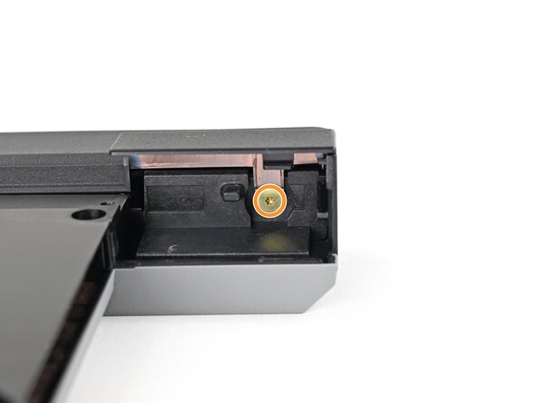

  11. Framework Laptop 16 Graphics Module Fan Replacement, Loosen the Graphics Module screws: paso 11, imagen 1 de 2 Framework Laptop 16 Graphics Module Fan Replacement, Loosen the Graphics Module screws: paso 11, imagen 2 de 2
    • Use your Framework Screwdriver to loosen the two captive T5 Torx screws securing the Graphics Module.
    • Close the interposer door before continuing.

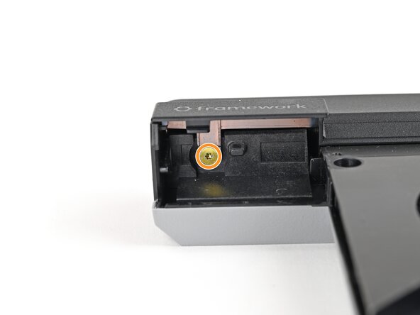

  13. Framework Laptop 16 Graphics Module Fan Replacement, Remove the Graphics Module cover screws: paso 13, imagen 1 de 3 Framework Laptop 16 Graphics Module Fan Replacement, Remove the Graphics Module cover screws: paso 13, imagen 2 de 3 Framework Laptop 16 Graphics Module Fan Replacement, Remove the Graphics Module cover screws: paso 13, imagen 3 de 3
    • Use your Framework Screwdriver to remove the four 3.6 mm‑long T5 Torx screws securing the Graphics Module cover:
    • Two screws on the flat surface of the module, next to the fans.
    • Two screws on the thin edge of the module, near the ends. You'll need to flip the module on its back edge to access them.

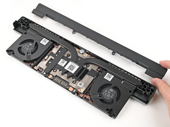

  14. Framework Laptop 16 Graphics Module Fan Replacement, Remove the Graphics Module cover: paso 14, imagen 1 de 3 Framework Laptop 16 Graphics Module Fan Replacement, Remove the Graphics Module cover: paso 14, imagen 2 de 3 Framework Laptop 16 Graphics Module Fan Replacement, Remove the Graphics Module cover: paso 14, imagen 3 de 3
    • Use your fingers to lift the cover off the Graphics Module and remove it.

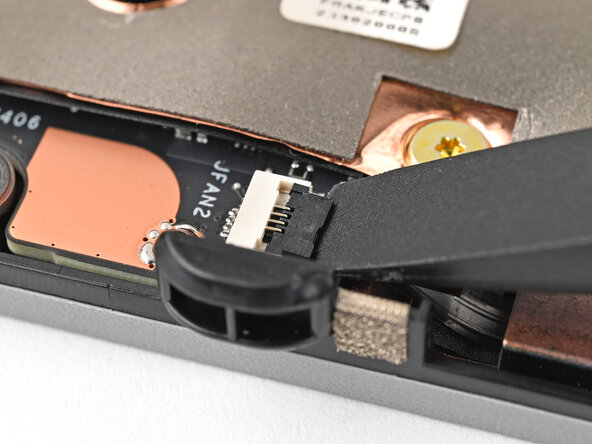

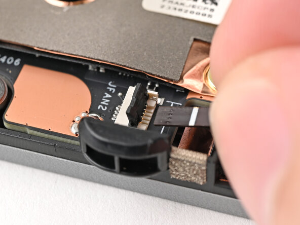

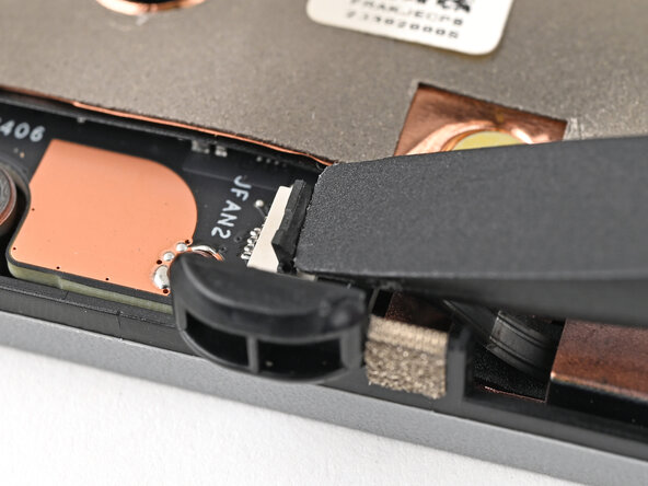

  15. Framework Laptop 16 Graphics Module Fan Replacement, Disconnect the fan: paso 15, imagen 1 de 3 Framework Laptop 16 Graphics Module Fan Replacement, Disconnect the fan: paso 15, imagen 2 de 3 Framework Laptop 16 Graphics Module Fan Replacement, Disconnect the fan: paso 15, imagen 3 de 3
    • Use the flat end of a spudger, or a clean fingernail, to lift up and release the locking tab on the fan ZIF connector.
    • Use your fingers to grip the brown pull tab and slide the fan cable straight out of its socket.

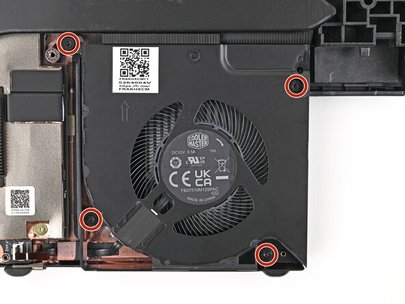

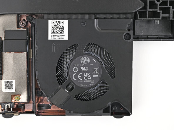

  16. Framework Laptop 16 Graphics Module Fan Replacement, Loosen the fan screws: paso 16, imagen 1 de 2 Framework Laptop 16 Graphics Module Fan Replacement, Loosen the fan screws: paso 16, imagen 2 de 2
    • Use a T5 Torx screwdriver to loosen the four captive screws securing the fan.

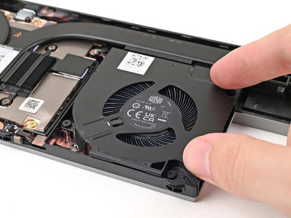

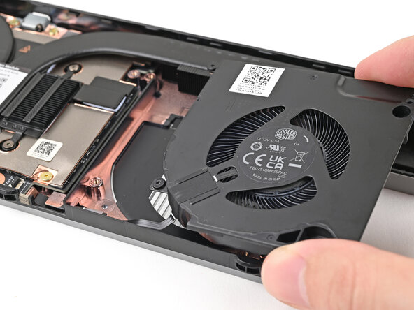

  17. Framework Laptop 16 Graphics Module Fan Replacement, Remove the fan: paso 17, imagen 1 de 3 Framework Laptop 16 Graphics Module Fan Replacement, Remove the fan: paso 17, imagen 2 de 3 Framework Laptop 16 Graphics Module Fan Replacement, Remove the fan: paso 17, imagen 3 de 3
    • Use one hand to press the fan cable flat to the module.
    • Use your other hand to pull the fan out of its housing, making sure to thread the cable though its slot.
    • Remove the fan.
  18. Framework Laptop 16 Graphics Module Fan Replacement, Disassembly complete: paso 18, imagen 1 de 1
    • Congratulations on completing disassembly! The remaining steps will show how to reassemble your Framework Laptop.

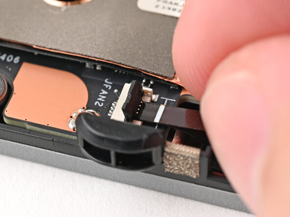

  21. Framework Laptop 16 Graphics Module Fan Replacement, Connect the fan: paso 21, imagen 1 de 3 Framework Laptop 16 Graphics Module Fan Replacement, Connect the fan: paso 21, imagen 2 de 3 Framework Laptop 16 Graphics Module Fan Replacement, Connect the fan: paso 21, imagen 3 de 3
    • Use your fingers to grip the brown pull tab and slide the fan cable straight into its socket.
    • Use the flat end of your Framework Screwdriver, or a clean fingernail, to press down the locking tab on the fan ZIF connector.
