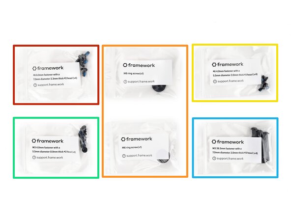

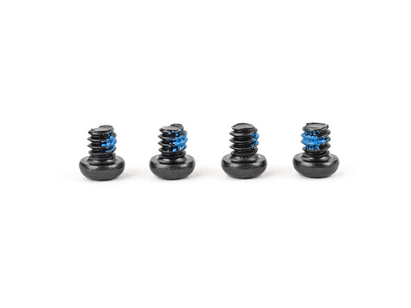

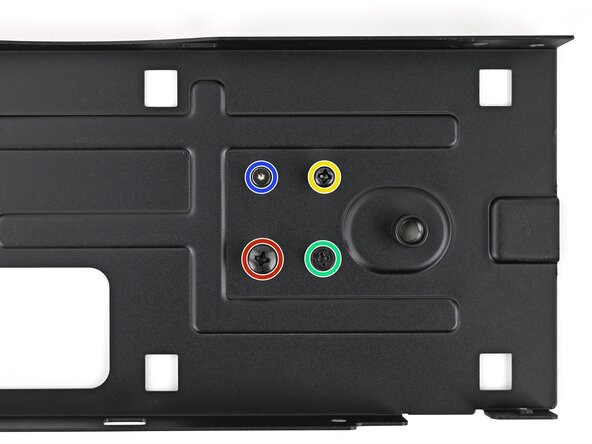

    • The Fastener Kit contains the following:
    • Four screws labeled "6.0 mm fastener with a 7.3 mm diameter 2.3 mm thick"
    • Two large screws labeled "M6 ring screws"
    • Four screws labeled "4.0 mm fastener with a 5.5 mm diameter 2.0 mm thick"
    • Eight screws labeled "4.0 mm fastener with a 5.5 mm diameter 0.9 mm thick"
    • Four long screws labeled "26.5 mm fastener with a 7.0 mm diameter 2.0 mm thick"
    • Your Framework Desktop comes with a spare screw of each size attached to the bottom of the top plate. You can use the Fastener Kit to replenish any screws you used there.

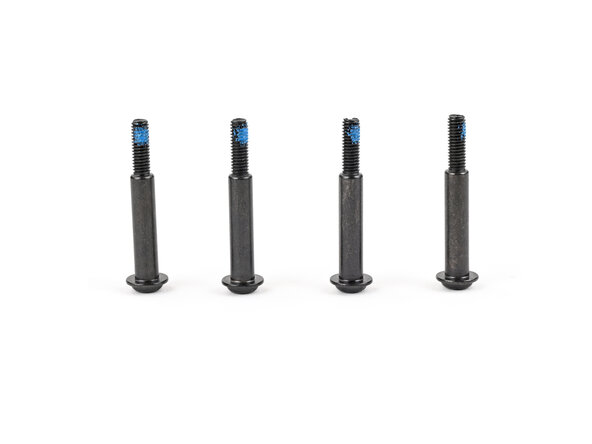

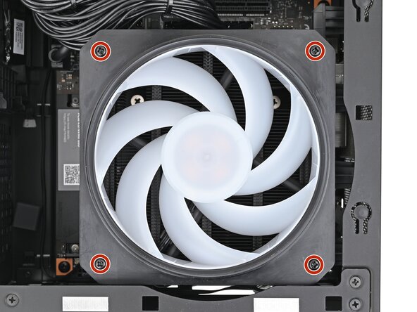

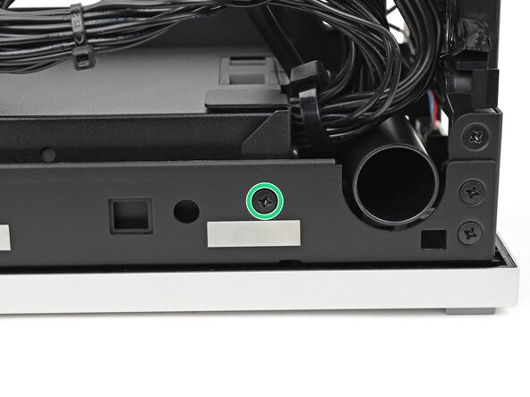

  3. Framework Desktop Fastener Kit, Fan screws: paso 3, imagen 1 de 2 Framework Desktop Fastener Kit, Fan screws: paso 3, imagen 2 de 2
    • The long screws labeled "26.5 mm fastener with a 7.0 mm diameter 2.0 mm thick" secure the Fan.

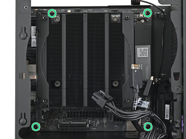

  4. Framework Desktop Fastener Kit, Mainboard screws: paso 4, imagen 1 de 2 Framework Desktop Fastener Kit, Mainboard screws: paso 4, imagen 2 de 2
    • The screws labeled "6.0 mm fastener with a 7.3 mm diameter 2.3 mm thick" secure the Mainboard.

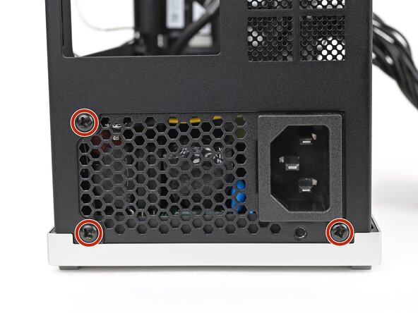

  5. Framework Desktop Fastener Kit, Power supply screws: paso 5, imagen 1 de 2 Framework Desktop Fastener Kit, Power supply screws: paso 5, imagen 2 de 2
    • The screws labeled "4.0 mm fastener with a 5.5 mm diameter 2.0 mm thick" secure the power supply.

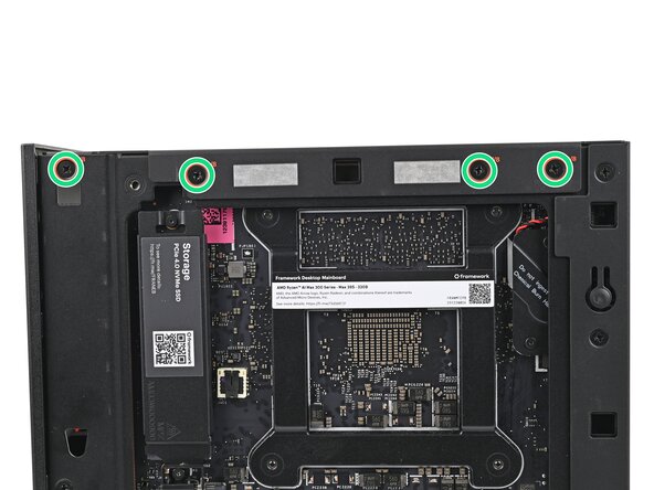

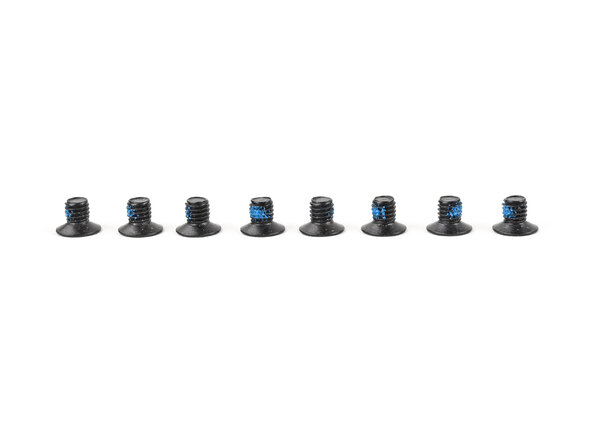

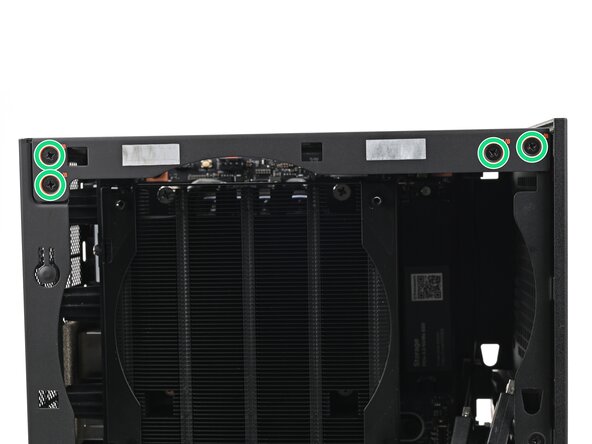

  6. Framework Desktop Fastener Kit, Top plate screws: paso 6, imagen 1 de 3 Framework Desktop Fastener Kit, Top plate screws: paso 6, imagen 2 de 3 Framework Desktop Fastener Kit, Top plate screws: paso 6, imagen 3 de 3
    • The screws labeled "4.0 mm fastener with a 5.5 mm diameter 0.9 mm thick" secure the top plate.

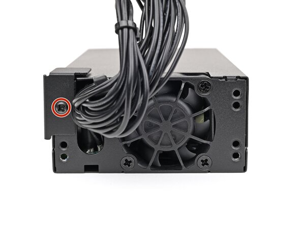

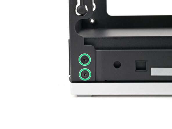

  8. Framework Desktop Fastener Kit, Side power supply screw: paso 8, imagen 1 de 2 Framework Desktop Fastener Kit, Side power supply screw: paso 8, imagen 2 de 2
    • The screws labeled "4.0 mm fastener with a 5.5 mm diameter 0.9 mm thick" secure the side of the power supply.
