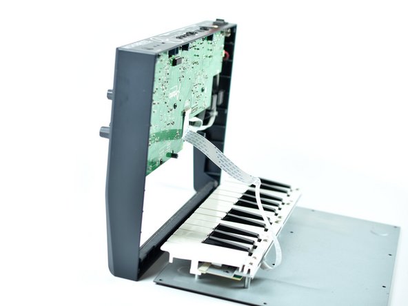

  3. Arturia Microbrute Opening Procedure: paso 3, imagen 1 de 3 Arturia Microbrute Opening Procedure: paso 3, imagen 2 de 3 Arturia Microbrute Opening Procedure: paso 3, imagen 3 de 3
    • Put the Microbrute on its front edge and carefully tilt open the bottom plate including the keyboard.
    • Be aware of the ribbon cable connecting the keyboard to the PCB.
    • The cable should give you enough slack to put the top section over the keyboard section for better handling.

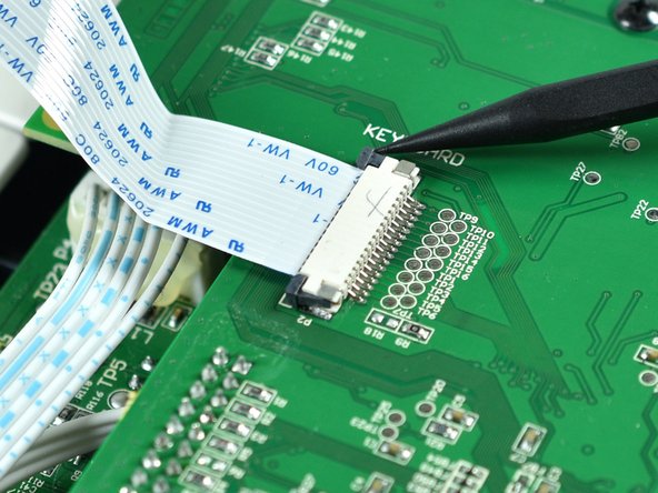

  4. Arturia Microbrute Opening Procedure: paso 4, imagen 1 de 1
    • Next, focus on the connector of the keyboard.

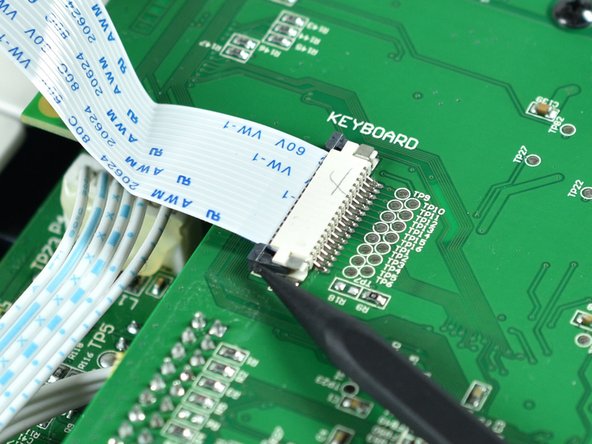

  5. Arturia Microbrute Opening Procedure: paso 5, imagen 1 de 3 Arturia Microbrute Opening Procedure: paso 5, imagen 2 de 3 Arturia Microbrute Opening Procedure: paso 5, imagen 3 de 3
    • Use a spudger to unlock the connector by pushing both left and right locking tabs tabs towards the cable.
  6. Arturia Microbrute Opening Procedure: paso 6, imagen 1 de 2 Arturia Microbrute Opening Procedure: paso 6, imagen 2 de 2
    • Grab the ribbon cable with your fingers and pull it out of the connector.

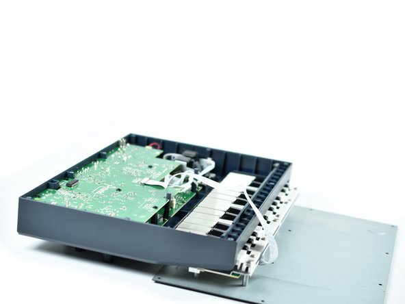

  7. Arturia Microbrute Opening Procedure: paso 7, imagen 1 de 1
    • Now the Microbrute is open and the bottom plate with the keyboard is separated from the rest of the device.
