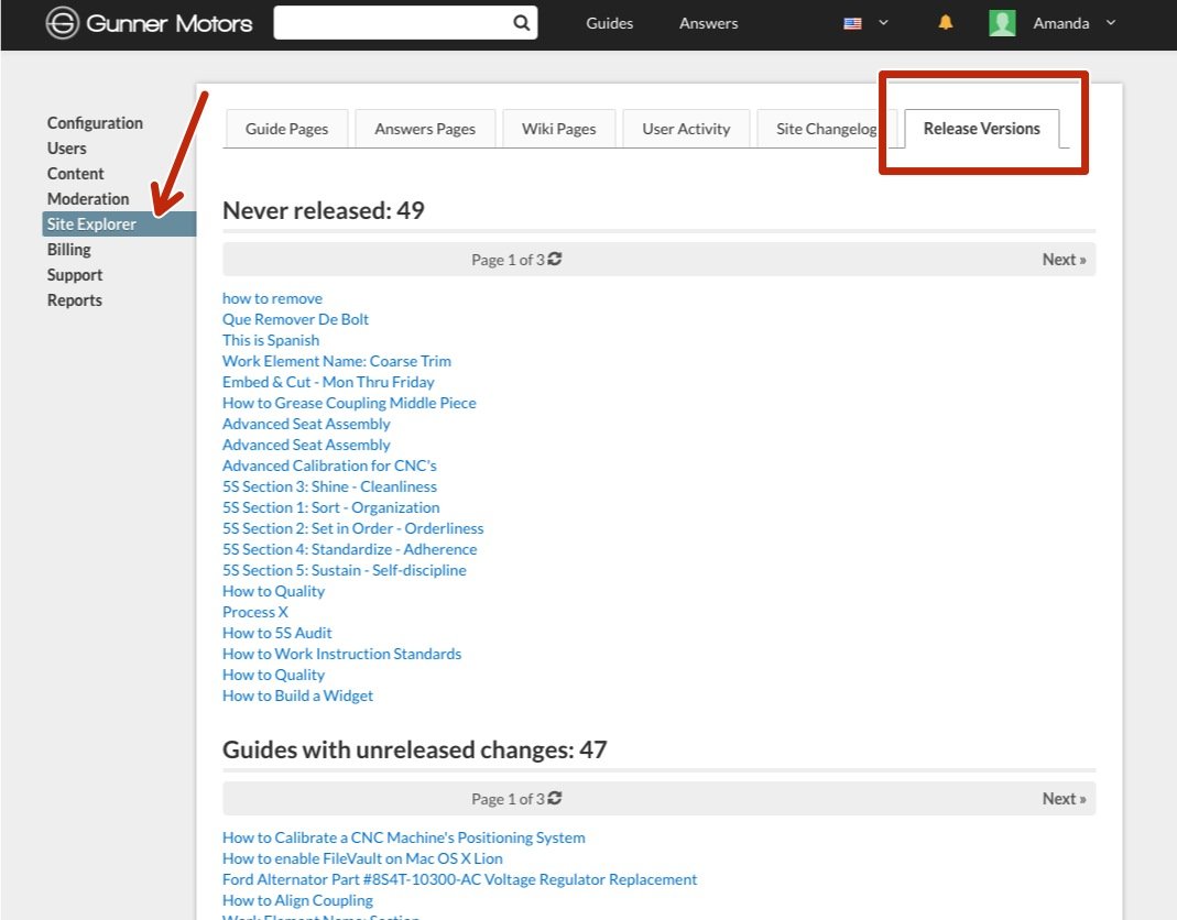

The Version Control Management page can be found in the Site Explorer in your Management Console:
The Version Control Management page gives you a quick view of every guide on your site—and displays the current release status of each guide. There are three release statuses: Never Released, Unreleased Changes, and Current Release.

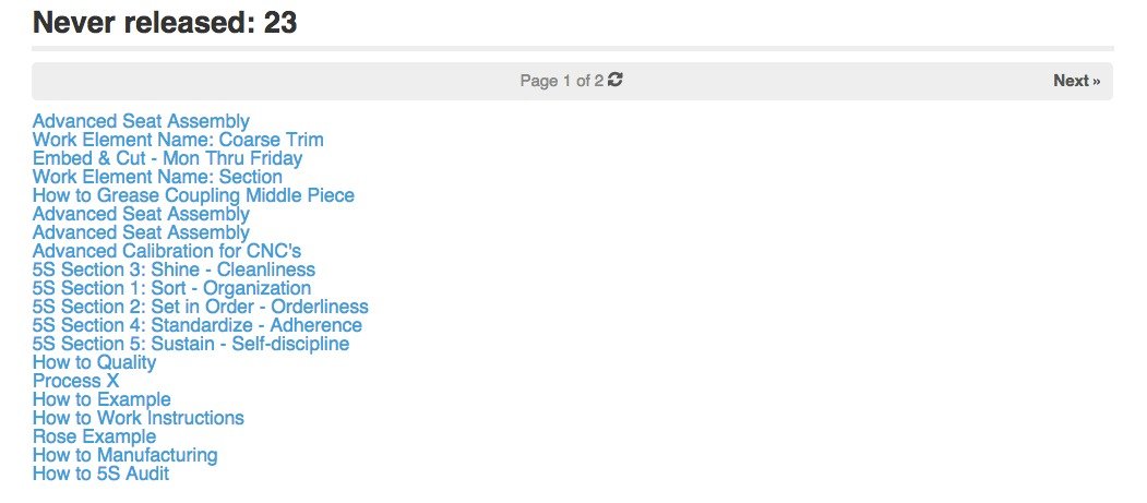

Never Released
The example section below lists 23 guides that have not had their first version published. These guides remain invisible to users until their first version is published.

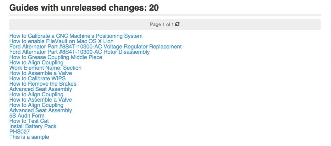

Unreleased Changes
The example section below lists 20 guides with edits that have not been published yet. The previous version of each guide will be displayed until the edits are published.

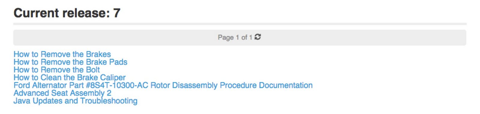

Current Release
The example section below lists 7 guides that are completely up-to-date. No unreleased changes have been made to these guides, and the viewable version of this guide is current.
