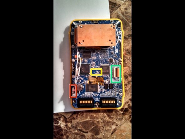

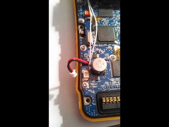

  5. TDS Trimble Spectra Precision Recon 400X LCD Digitizer Replacement: paso 5, imagen 1 de 3 TDS Trimble Spectra Precision Recon 400X LCD Digitizer Replacement: paso 5, imagen 2 de 3 TDS Trimble Spectra Precision Recon 400X LCD Digitizer Replacement: paso 5, imagen 3 de 3
    • Flip up the connector using a spudger and gently pull the ribbon cable out. This is the display assembly connector. Next we will gently pull the power cable up using a spudger or pry tool. The area marks by the yellow rectangle comes into play in the next step. This is where the keypad connects to the motherboard.
  6. TDS Trimble Spectra Precision Recon 400X LCD Digitizer Replacement: paso 6, imagen 1 de 1
    • Now we can remove the motherboard. Simply remove the 11 screws using a T6 torx driver. The motherboard must be lifted straight up. The keypad is connected from underneath the motherboard. It will unplug as you lift the board. That is what you want to happen
