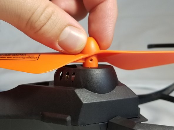

    • Rotate the propeller to locate the propeller set screw.
  2. Propeller Replacement: paso 2, imagen 1 de 2 Propeller Replacement: paso 2, imagen 2 de 2
    • Unscrew the single 4 mm Phillips screw.
  3. Propeller Replacement: paso 3, imagen 1 de 3 Propeller Replacement: paso 3, imagen 2 de 3 Propeller Replacement: paso 3, imagen 3 de 3
    • Slide the propeller up and off the motor assembly.

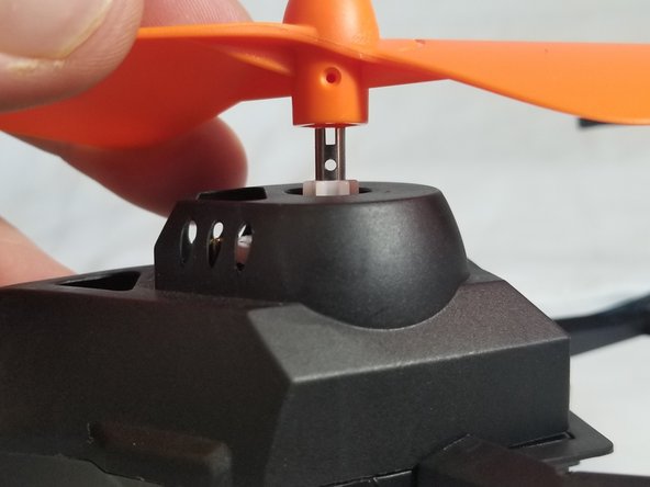

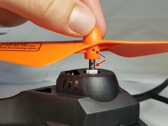

  4. Propeller Replacement: paso 4, imagen 1 de 3 Propeller Replacement: paso 4, imagen 2 de 3 Propeller Replacement: paso 4, imagen 3 de 3
    • To attach the new propeller, align the hexagonal slot in the propeller base with the keyed motor shaft.
    • Ensure one of the screw holes on the motor shaft aligns with the propeller screw hole.
    • Slide the propeller onto the motor shaft.
