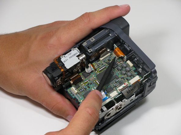

  13. Panasonic PV-GS9 Motherboard Replacement, Motherboard: paso 13, imagen 1 de 3 Panasonic PV-GS9 Motherboard Replacement, Motherboard: paso 13, imagen 2 de 3 Panasonic PV-GS9 Motherboard Replacement, Motherboard: paso 13, imagen 3 de 3
    • Using the spudger, remove the few remaining ribbon cables from the logic board.

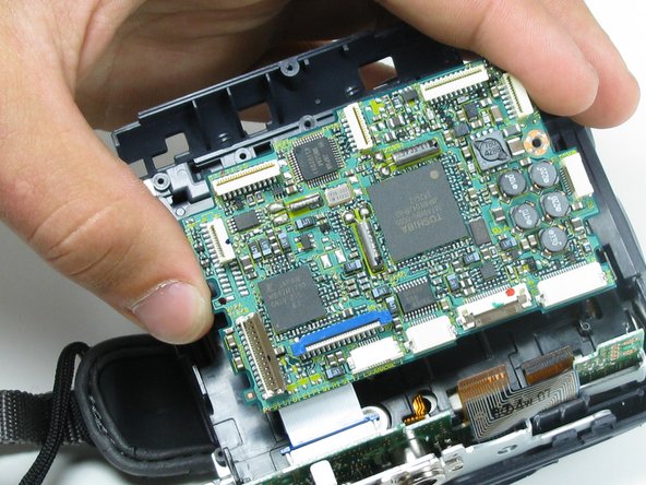

  14. Panasonic PV-GS9 Motherboard Replacement: paso 14, imagen 1 de 3 Panasonic PV-GS9 Motherboard Replacement: paso 14, imagen 2 de 3 Panasonic PV-GS9 Motherboard Replacement: paso 14, imagen 3 de 3
    • To remove the logic board from the body, use the #00 phillips head screwdriver and remove the 4mm silver screw from right side of the board.
    • Next, rotate the camcorder so the front is facing you and remove the 4mm silver screw from the front panel.
    • Carefully lift the logic board away from the camcorder.
