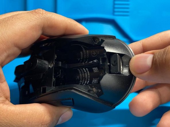

    • Start at the same location as the previous step, and use your thumb to carefully pry the base from the shell of the mouse.
  4. Logitech G603 Switch Replacement: paso 4, imagen 1 de 3 Logitech G603 Switch Replacement: paso 4, imagen 2 de 3 Logitech G603 Switch Replacement: paso 4, imagen 3 de 3
    • Now that we have displaced the lower half we need to move to the front of the mouse.
    • There will be two crevices that are attaching the base to the shell of the mouse.
    • Using a spudger, gently and carefully pry along the dotted red line marked in the first photo until the shell and the base are separated.
    • As soon as the base and shell are separated, be careful not to pull them apart as they are still connected via a power and ribbon cable.

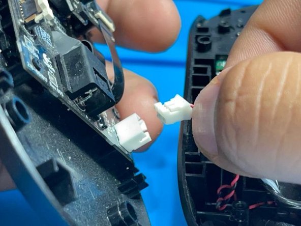

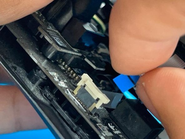

  6. Logitech G603 Switch Replacement: paso 6, imagen 1 de 3 Logitech G603 Switch Replacement: paso 6, imagen 2 de 3 Logitech G603 Switch Replacement: paso 6, imagen 3 de 3
    • To remove the ribbon cable, use your thumb and index finger to pinch the latch upwards.
    • Once the latch has been released, pull the cable out of its slot.

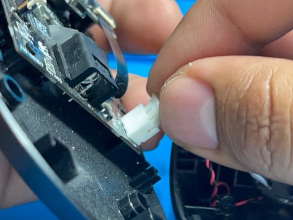

  7. Logitech G603 Switch Replacement: paso 7, imagen 1 de 3 Logitech G603 Switch Replacement: paso 7, imagen 2 de 3 Logitech G603 Switch Replacement: paso 7, imagen 3 de 3
    • To remove the power cable, slowly and carefully wiggle the cable out of its socket either with your fingers, a spudger, or a flat head screwdriver.
    • Take your time with this process as the connection is a tight fit and might accidentally remove the socket with the cable.

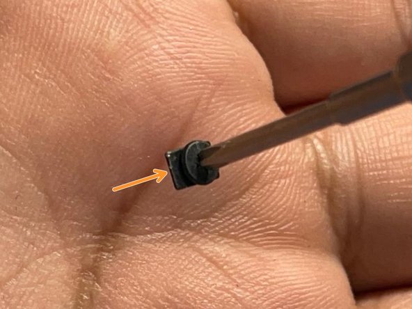

  9. Logitech G603 Switch Replacement: paso 9, imagen 1 de 3 Logitech G603 Switch Replacement: paso 9, imagen 2 de 3 Logitech G603 Switch Replacement: paso 9, imagen 3 de 3
    • Because the mouse switch circuit board is connected to the side button circuit board, we will need to remove the screw guard that keeps it fastened to the mouse.
    • Locate the screw marked in the first photo. Remove it by using a Philips head screw driver and twisting in a counter-clockwise motion.
    • Make sure not to lose the guard underneath the head of the screw as it keeps the circuit board from falling out of place.

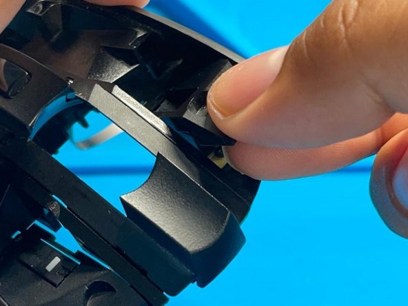

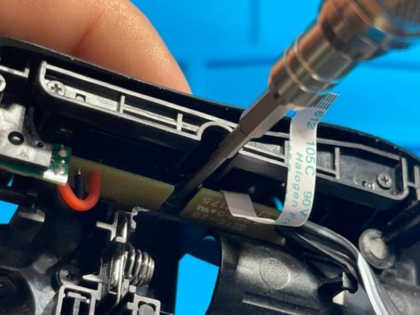

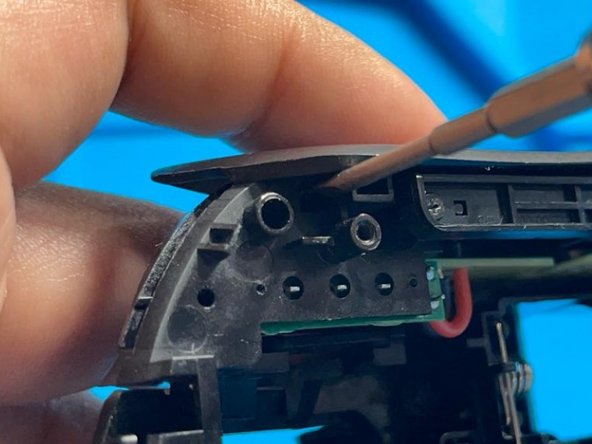

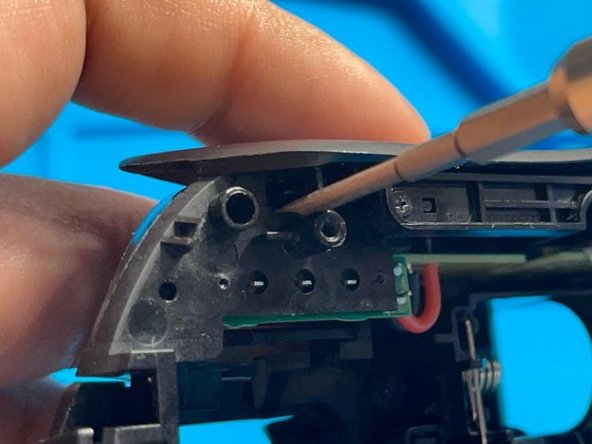

  10. Logitech G603 Switch Replacement: paso 10, imagen 1 de 3 Logitech G603 Switch Replacement: paso 10, imagen 2 de 3 Logitech G603 Switch Replacement: paso 10, imagen 3 de 3
    • The switch will be hidden under a cover to prevent debris from entering the device or being displaced. This step will remove that cover.
    • The cover will be secured by a latch and a screw.
    • Use a screwdriver to remove the screw by twisting in a counter-clockwise motion.
    • Using a flat head screwdriver, push the latch upwards and into hole from which it protrudes until the cover loosens.
    • Do not forget to separate and categorize your screws for when the mouse is being put together.

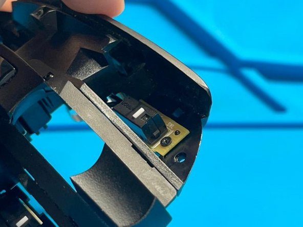

  11. Logitech G603 Switch Replacement: paso 11, imagen 1 de 3 Logitech G603 Switch Replacement: paso 11, imagen 2 de 3 Logitech G603 Switch Replacement: paso 11, imagen 3 de 3
    • Using your index finger and thumb carefully displace the cover to reveal the switch.

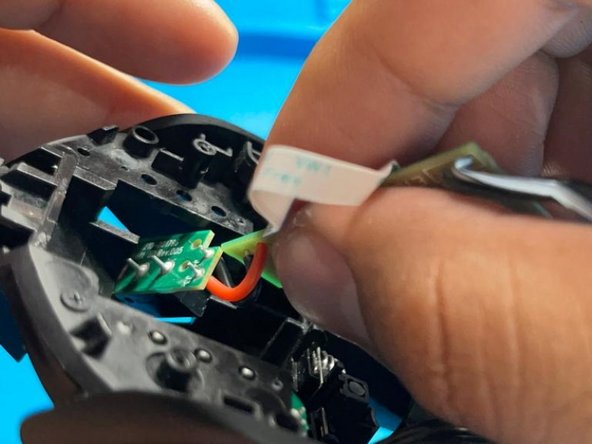

  12. Logitech G603 Switch Replacement: paso 12, imagen 1 de 3 Logitech G603 Switch Replacement: paso 12, imagen 2 de 3 Logitech G603 Switch Replacement: paso 12, imagen 3 de 3
    • The switch board will be secured by two screws. Using a Philips head screwdriver, remove the two screws using a counter-clockwise motion.
  13. Logitech G603 Switch Replacement: paso 13, imagen 1 de 2 Logitech G603 Switch Replacement: paso 13, imagen 2 de 2
    • Using a spudger or a flat head screwdriver lift the circuit board from its slot.

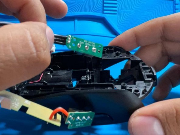

  14. Logitech G603 Switch Replacement: paso 14, imagen 1 de 2 Logitech G603 Switch Replacement: paso 14, imagen 2 de 2
    Herramienta utilizada en este paso:
    • To reiterate, the mouse switch board is held down by the side button circuit board. Now that we have unfastened the side board, use tweezers to dislodge it out of its slot.
    • Once there is enough room, pinch the board loose with your index finger and thumb
  15. Logitech G603 Switch Replacement: paso 15, imagen 1 de 3 Logitech G603 Switch Replacement: paso 15, imagen 2 de 3 Logitech G603 Switch Replacement: paso 15, imagen 3 de 3
    • With the side board in hand, twist the board until there is enough room for the switch board to exit the gap located in the last photo.
