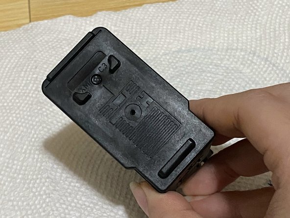

  3. How to Refill Canon Pixma MG3550 Ink Cartridges: paso 3, imagen 1 de 3 How to Refill Canon Pixma MG3550 Ink Cartridges: paso 3, imagen 2 de 3 How to Refill Canon Pixma MG3550 Ink Cartridges: paso 3, imagen 3 de 3
    • Remove the sticker label on the cartridge.
    • After removing the label, you will see a hole.
    • The black ink cartridge has one hole, and the color ink cartridge has three holes.
