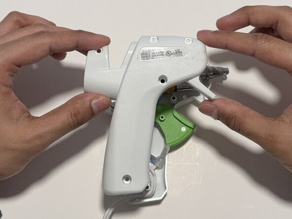

      • Unplug the hot glue gun and let it cool completely before handling it.
      • Place the glue gun on a stable surface to begin the repair.

      • Using a Phillips #0 screwdriver, remove the five screws from the side of the glue gun.
      • Gently pry apart the outer casing into two halves.
      • If you're having trouble separating the two halves of the gun, use a spudger to release the clips along the seam.
