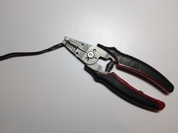

  3. How to Create a DCPS for Cheap, The Wall Wart: paso 3, imagen 1 de 3 How to Create a DCPS for Cheap, The Wall Wart: paso 3, imagen 2 de 3 How to Create a DCPS for Cheap, The Wall Wart: paso 3, imagen 3 de 3
    • Use the biggest wall wart you have lying around. I had a 12 volt, 2.5 amp one that used to power a router, so I used that.
    • Take a pair of wire strippers, cut the plug off, and strip the two wires. Make sure you know which end is positive and which end is negative.
    • The stripped wire ends.

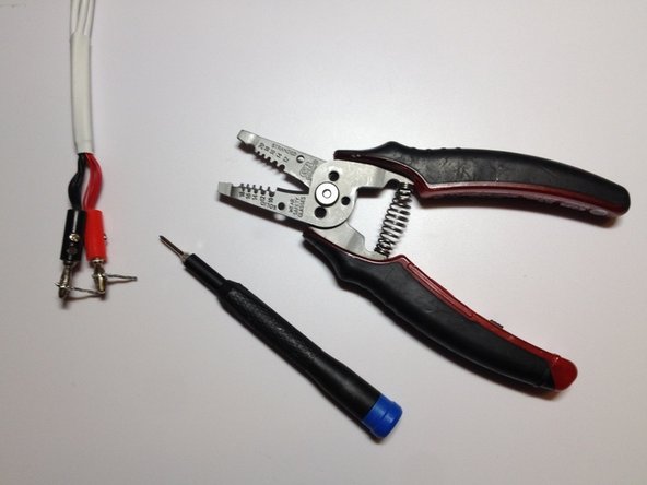

  4. How to Create a DCPS for Cheap, Preparing the Cable: paso 4, imagen 1 de 3 How to Create a DCPS for Cheap, Preparing the Cable: paso 4, imagen 2 de 3 How to Create a DCPS for Cheap, Preparing the Cable: paso 4, imagen 3 de 3
    • My cable came with banana plugs, so I soldered little 90-degree wires so that it would connect to the DC-DC converter. Make sure to insulate them!
    • If you don't want to (or are not allowed) to solder, unscrew the banana plugs and strip the small red wires going to the plugs.
    • For those of you going the ghetto route, solder two pieces of wire to the positive and negative terminals where the battery would connect to the control board.

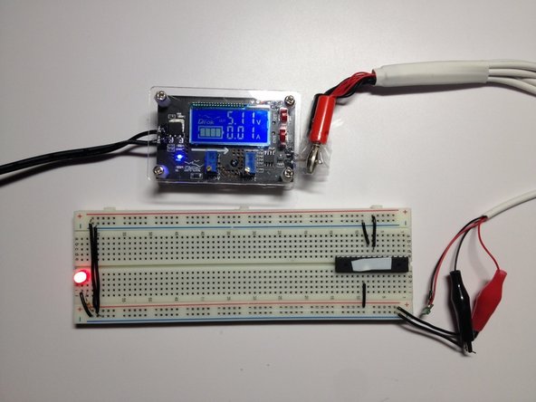

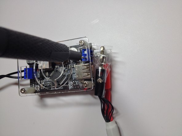

  5. How to Create a DCPS for Cheap, Assembly: paso 5, imagen 1 de 3 How to Create a DCPS for Cheap, Assembly: paso 5, imagen 2 de 3 How to Create a DCPS for Cheap, Assembly: paso 5, imagen 3 de 3
    • Screw the cables into their sockets.
    • Do NOT mix up positive and negative!
    • Alternatively, you could use alligator clips to connect the cables. Don't forget to insulate them!
  6. How to Create a DCPS for Cheap, The DCPS: paso 6, imagen 1 de 3 How to Create a DCPS for Cheap, The DCPS: paso 6, imagen 2 de 3 How to Create a DCPS for Cheap, The DCPS: paso 6, imagen 3 de 3
    • IT'S ALIVE!
    • Now you have an excellent tool to repair iPhones with . . .
    • . . . And much more!
