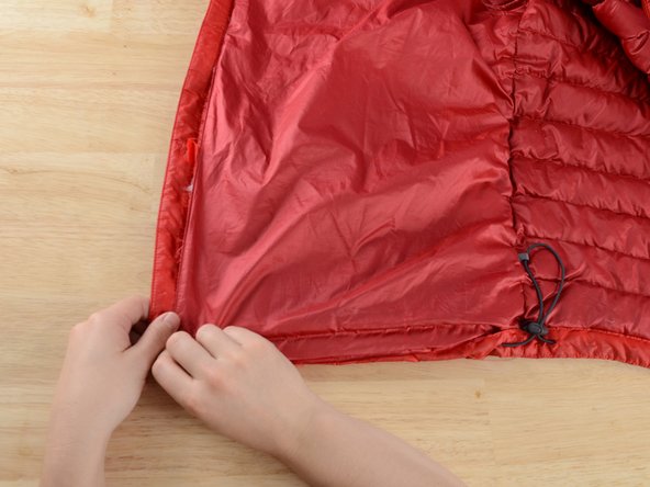

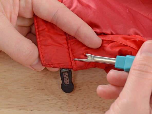

  2. How to Access the Insides of a Patagonia Down Jacket: paso 2, imagen 1 de 2 How to Access the Insides of a Patagonia Down Jacket: paso 2, imagen 2 de 2
    • Find the closest seam to the area that needs repair. In our case, it’s the bottom seam of the jacket.
    • Using a seam ripper, gently pull out the visible stitches on the seam.
    • Seam rippers are sharp, and it’s easy to puncture or tear the fabric of the jacket. Be sure you’re only ripping the stitches and not the jacket itself. Take your time.
  3. How to Access the Insides of a Patagonia Down Jacket: paso 3, imagen 1 de 2 How to Access the Insides of a Patagonia Down Jacket: paso 3, imagen 2 de 2
    • Rip the seam until you have ripped several inches of seam on either side of the hole. Then continue ripping in the direction of the nearest perpendicular seam. In the case illustrated here, it’s the zipper seam.
    • With this seam ripped, you should see the baffles inside of the jacket.
