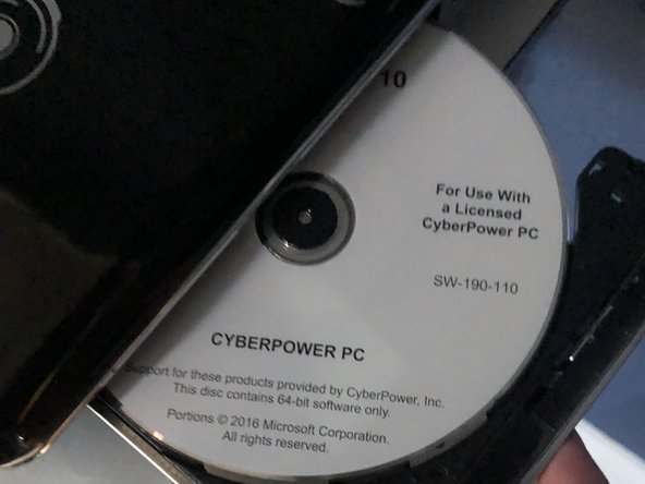

      • Locate the small hole on the right side of the disk tray next to the release button.

    2. HP Pavilion dv6t-1200 Disk Tray Motor Replacement: paso 2, imagen 1 de 2 HP Pavilion dv6t-1200 Disk Tray Motor Replacement: paso 2, imagen 2 de 2
      • Extend the paper clip into a straight line and insert it into the disk tray hole located next to the release button.
      • Do not poke the optical light button to the middle left of the release button. The disk tray hole is to the bottom right of the tray release button.
      • When the disk tray is removed, clean your workspace and the tray with canned air.
