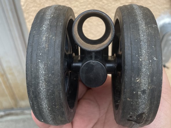

    6. Foldable Shopping Cart Swivel Wheels Replacement: paso 6, imagen 1 de 3 Foldable Shopping Cart Swivel Wheels Replacement: paso 6, imagen 2 de 3 Foldable Shopping Cart Swivel Wheels Replacement: paso 6, imagen 3 de 3
      • Prepare the new wheels by ensuring the axle is clear from both sides.
      • Ensure the axle is closing in a bit on one end, as this will help lock it in.

    7. Foldable Shopping Cart Swivel Wheels Replacement: paso 7, imagen 1 de 2 Foldable Shopping Cart Swivel Wheels Replacement: paso 7, imagen 2 de 2
      • Slide the new wheel into the cart.
      • The clear end of the axle should be inserted first.
