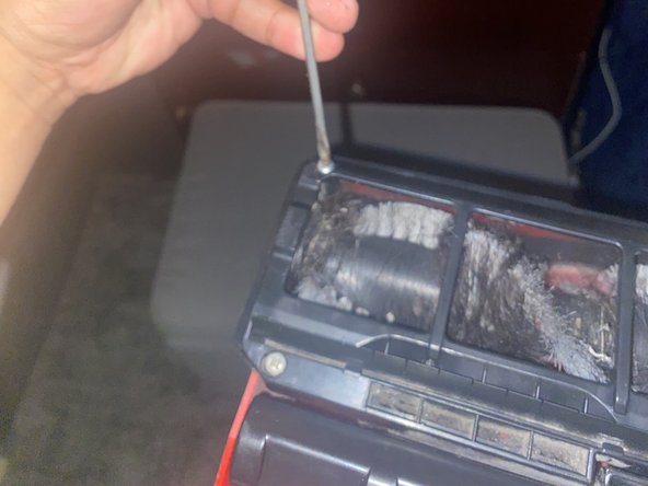

    • Flip the vacuum over
    • Use your Torx drive to unscrew 6 to 8 M2-0.89 x 4.5 mm Type PT Style Thread Forming Screws

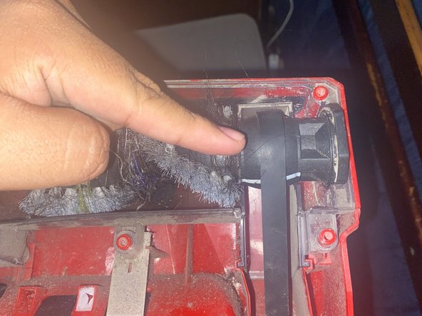

    • Grab the vacuum cleaner belt motor clutch and place it on the right side of the vacuum brush.
    • Then connect the vacuum cleaner belt motor clutch where the metal pole is on the right back side to connect the vacuum brush together

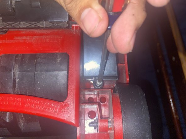

    • When the cover is placed all together you will need your 8 to 6 M2-0.89 x 4.5 mm Type PT Style Thread Forming Screws
    • screw all the sides with your Torx drive to screw them in back in place
