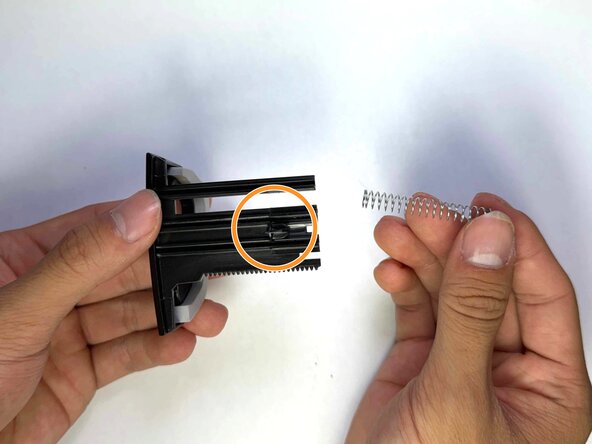

  3. Fixing The Wings of a Car Phone Mount/Holder: paso 3, imagen 1 de 3 Fixing The Wings of a Car Phone Mount/Holder: paso 3, imagen 2 de 3 Fixing The Wings of a Car Phone Mount/Holder: paso 3, imagen 3 de 3
    • Identify the correct wing.
    • Using your fingers, place the spring on the small projection on the wing.
