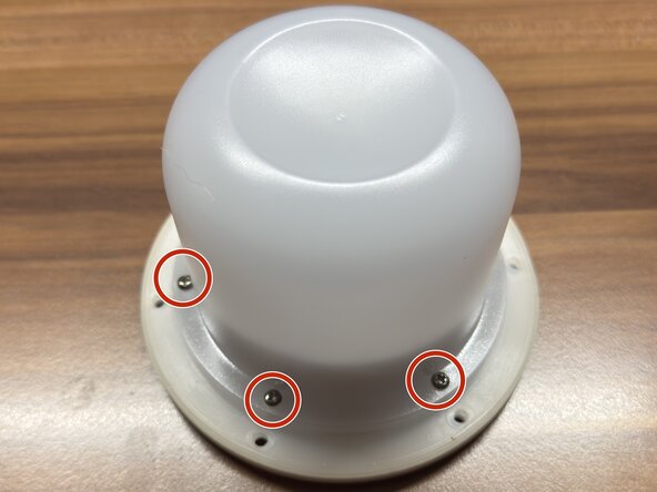

  1. Eve Flare Model 20EAX9901 Battery Replacement, Turn lightbulb upside down: paso 1, imagen 1 de 1
    • Turn the lightbulb upside down and remove the rubber feet.
    Pregunta a FixBot
    Agregar Comentario
  2. Eve Flare Model 20EAX9901 Battery Replacement, Remove the head of it: paso 2, imagen 1 de 1
    • Use a PH2 screwdriver to remove all 6 screws.
    • Afterwards remove the top
