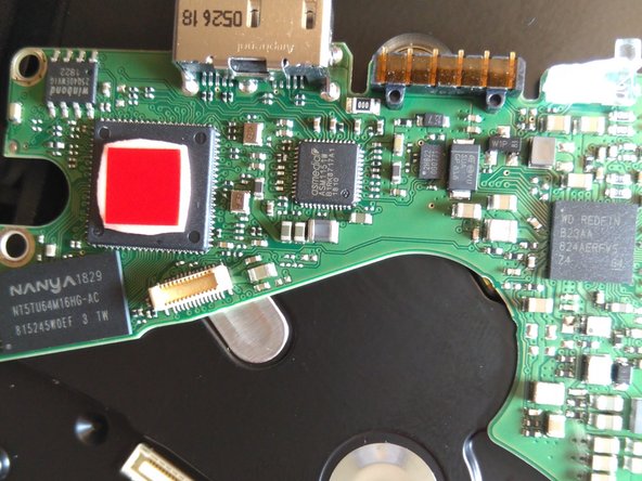

  3. Disassembling Western Digital Elements SE HD case and mainboard, Lift up the board: paso 3, imagen 1 de 2 Disassembling Western Digital Elements SE HD case and mainboard, Lift up the board: paso 3, imagen 2 de 2
    • Lift the board gently - there is only one small connector connecting the board to the hard disk case (around the yellow market space).
    • On the second image, you can see the board turned over.
    • Further disassembly would damage the disk. I hoped to find a SATA connector within, but maybe someone knows an alternative board with the same connector.
