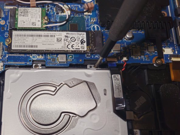

  9. Acer Predator Helios 300 PH315-53 SATA Hard Disk Drive (HDD) / Solid State Drive (SDD) Replacement, SATA Hard Disk Drive (HHD) or Solid State Drive (SDD): paso 9, imagen 1 de 2 Acer Predator Helios 300 PH315-53 SATA Hard Disk Drive (HDD) / Solid State Drive (SDD) Replacement, SATA Hard Disk Drive (HHD) or Solid State Drive (SDD): paso 9, imagen 2 de 2
    • Remove the four screws that secure the SATA drive to the top case.
    Pregunta a FixBot

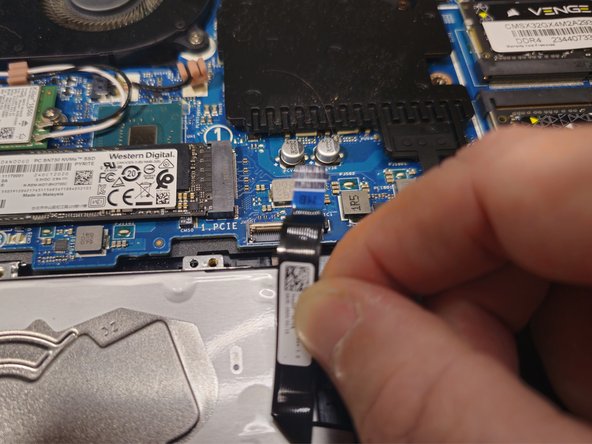

  10. Acer Predator Helios 300 PH315-53 SATA Hard Disk Drive (HDD) / Solid State Drive (SDD) Replacement: paso 10, imagen 1 de 3 Acer Predator Helios 300 PH315-53 SATA Hard Disk Drive (HDD) / Solid State Drive (SDD) Replacement: paso 10, imagen 2 de 3 Acer Predator Helios 300 PH315-53 SATA Hard Disk Drive (HDD) / Solid State Drive (SDD) Replacement: paso 10, imagen 3 de 3
    • Using a spudger, gently lift the white retaining-bracket that secures the SATA III cable to the motherboard.
    • With the retaining-bracket lifted, remove the SATA III cable from the motherboard.
