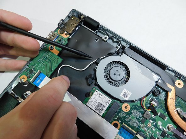

  6. Acer Chromebook CP5-471-C0EX Fan Replacement, Fan: paso 6, imagen 1 de 2 Acer Chromebook CP5-471-C0EX Fan Replacement, Fan: paso 6, imagen 2 de 2
    • Gently pull the black and white cables up to disconnect them from the Wi-Fi card.
  7. Acer Chromebook CP5-471-C0EX Fan Replacement: paso 7, imagen 1 de 3 Acer Chromebook CP5-471-C0EX Fan Replacement: paso 7, imagen 2 de 3 Acer Chromebook CP5-471-C0EX Fan Replacement: paso 7, imagen 3 de 3
    • Unwind the Wi-Fi card wires from the side of the fan.
    • The wires need to be pulled down and around the first hook, as seen in image two.
    • Pull the black and white cables under the second hook and away from the fan.
  8. Acer Chromebook CP5-471-C0EX Fan Replacement: paso 8, imagen 1 de 3 Acer Chromebook CP5-471-C0EX Fan Replacement: paso 8, imagen 2 de 3 Acer Chromebook CP5-471-C0EX Fan Replacement: paso 8, imagen 3 de 3
    • Pull wires so they are out the way.
    • Loosen the six screws from the fan and heat sink.
    • The two screws closest to the fan cannot be removed from the fan, but will still loosen from the case.

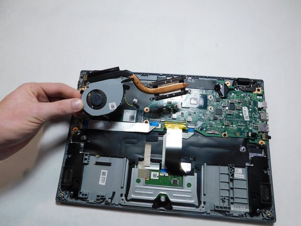

  9. Acer Chromebook CP5-471-C0EX Fan Replacement: paso 9, imagen 1 de 3 Acer Chromebook CP5-471-C0EX Fan Replacement: paso 9, imagen 2 de 3 Acer Chromebook CP5-471-C0EX Fan Replacement: paso 9, imagen 3 de 3

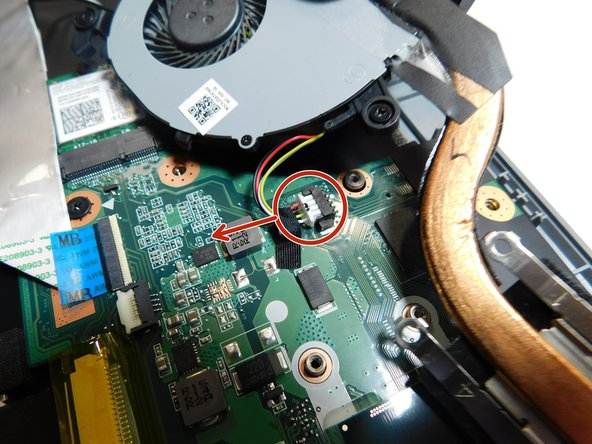

    • Gently lift the fan out of the case, but do not remove it fully; there is still one more cable attached.
    • Pull the cable out of its socket on the motherboard.
    • Remove the fan from the laptop.
