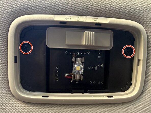

  3. 2014-Present Kia Sedona Cargo Lamp Assembly Replacement, Remove the lamp assembly: paso 3, imagen 1 de 1
    • Use a Phillips screwdriver to remove the two screws securing the lamp assembly.
