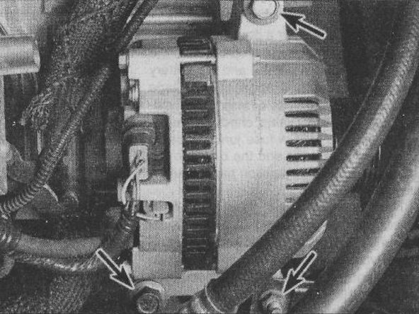

Here is the alternator that is apparently not charging. First thing is to test it to make sure it is the problem.
B+ is the post where one can test the output voltage of the alternator with a simple multimeter.
Set the multimeter to 50 DC Volt scale. Black probe to ground and red probe to B+ on the alternator. With the engine running the voltmeter should show around 14 Volts. On this alternator the voltage does not increase and sits somewhere around 10 Volts. Good indication that it needs to be changed.
First thing is to disconnect the battery. I habitually only disconnect the negative cable.
This is the only part that may be difficult. The removal of the serpentine belt requires that the spring loaded belt tensioner gets pulled to the point that it no longer applies tightening pressure onto the belt. It requires a Torx T-50 which I did not have.
The proper way would be to insert the T-50 into the tensioner and then move that into counterclockwise direction to loosen
Where there is a will there is a way. Use a 15mm socket on the bolt that holds the idler wheel. Use the ratchet and move that into a counterclockwise direction. This will loosen the tensioner and the belt can now be removed.
