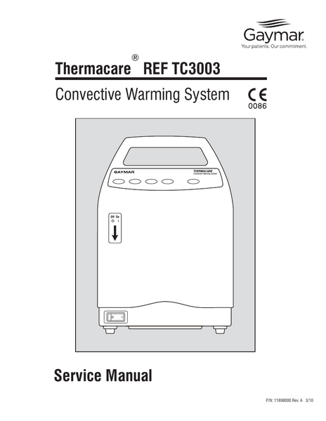

Thermacare ® REF TC3003
Convective Warming System
Service Manual
Before you begin . . .
Important
  • Refer to the TC3003 Convective Warming System Operating Manual for detailed operating instructions. Read and understand the Operating Manual and all precautions prior to using the Convective Warming System.
  • Review the SAFETY PRECAUTIONS (see page 2) prior to servicing the Convective Warming Unit (Power Unit).
  • For technical assistance, contact your local dealer.
NOTE: Extremely high storage temperatures (such as those found in rail cars or automobile trunks on hot summer days) can cause the thermostats within this device to actuate. Should this occur, the REMOVE FROM USE indicator will light when the Power Unit is turned on. If this happens, the thermostats must be manually reset. Refer to section 7, Functional Check and Safety Inspection.
