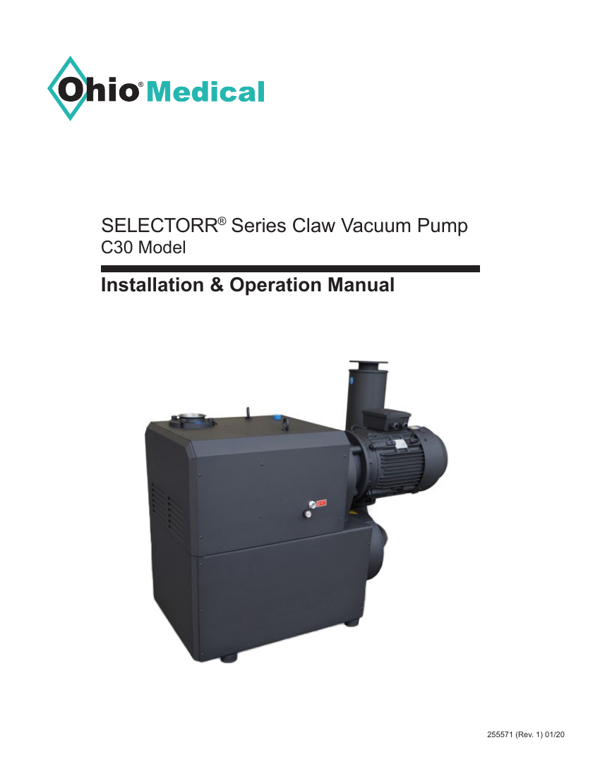

SELECTORR Series Claw Vacuum Pump C30 Model Installation & Operation Manual
SELECTORR ® Series Claw Vacuum Pump C30 Model
INSTALLATION & OPERATING MANUAL SELECTORR ® SERIES CLAW VACUUM PUMPS C30
Please read the manual before operating the vacuum pump.
