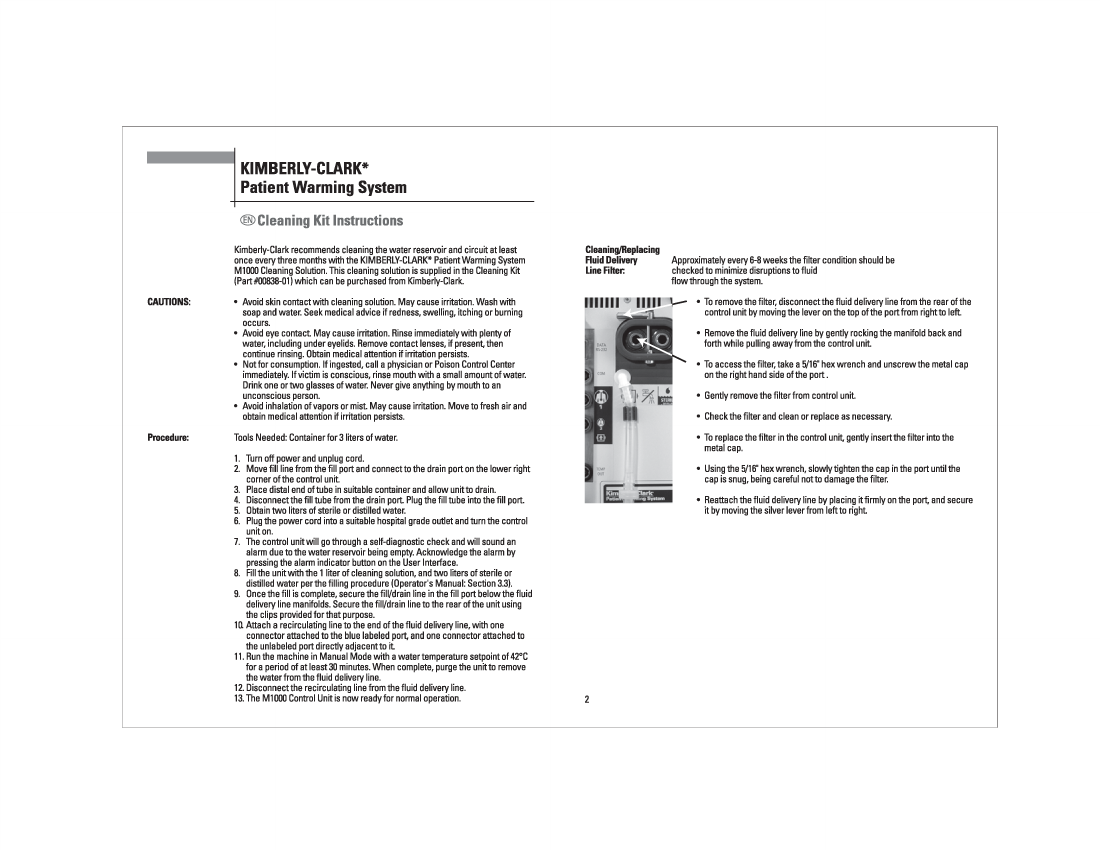

CAUTIONS:
Procedure:
KIMBERLY-CLARK* Patient Warming System
€ Cleaning Kit Instructions
Kimberly-Clark recommends cleaning the water reservoir and circuit at least once every three months with the KIMBERLY-CLARK* Patient Warming System M1000 Cleaning Solution. This cleaning solution is supplied in the Cleaning Kit {Part #00838-01) which can be purchased from Kimberly-Clark.
  • e Avoid skin contact with cleaning solution. May cause irritation. Wash with soap and water. Seek medical advice if redness, swelling, itching or burning occurs.
  • Avoid eye contact. May cause irritation. Rinse immediately with plenty of water, including under eyelids. Remove contact lenses, if present, then continue rinsing. Obtain medical attention if irritation persists.
  • Not for consumption. If ingested, call a physician or Poison Control Center immediately. If victim is conscious, rinse mouth with a small amount of water. Drink one or two glasses of water. Never give anything by mouth to an unconscious person.
  • Avoid inhalation of vapors or mist. May cause irritation. Move to fresh air and obtain medical attention if irritation persists.
Tools Needed: Container for 3 liters of water.
  1. Turn off power and unplug cord.
  2. Move fill line from the fill port and connect to the drain port on the lower right corner of the control unit.
  3. Place distal end of tube in suitable container and allow unit to drain.
  4. 4, Disconnect the fill tube from the drain port. Plug the fill tube into the fill port.
  5. Obtain two liters of sterile or distilled water.
  6. Plug the power cord into a suitable hospital grade outlet and turn the control unit on.
  7. The control unit will go through a self-diagnostic check and will sound an alarm due to the water reservoir being empty. Acknowledge the alarm by pressing the alarm indicator button on the User Interface.
  8. Fill the unit with the 1 liter of cleaning
